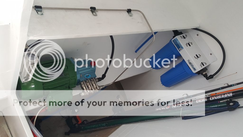

a few pics -
Tucked it into the forward closet area...

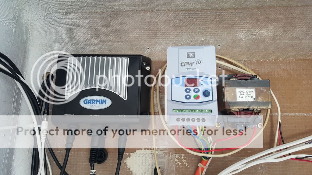

The VSD and line reactor which drives the little 0.75kW 3phase motor/ CATpump.

a few pics -
