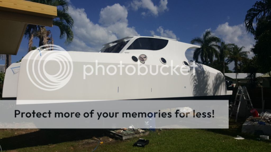

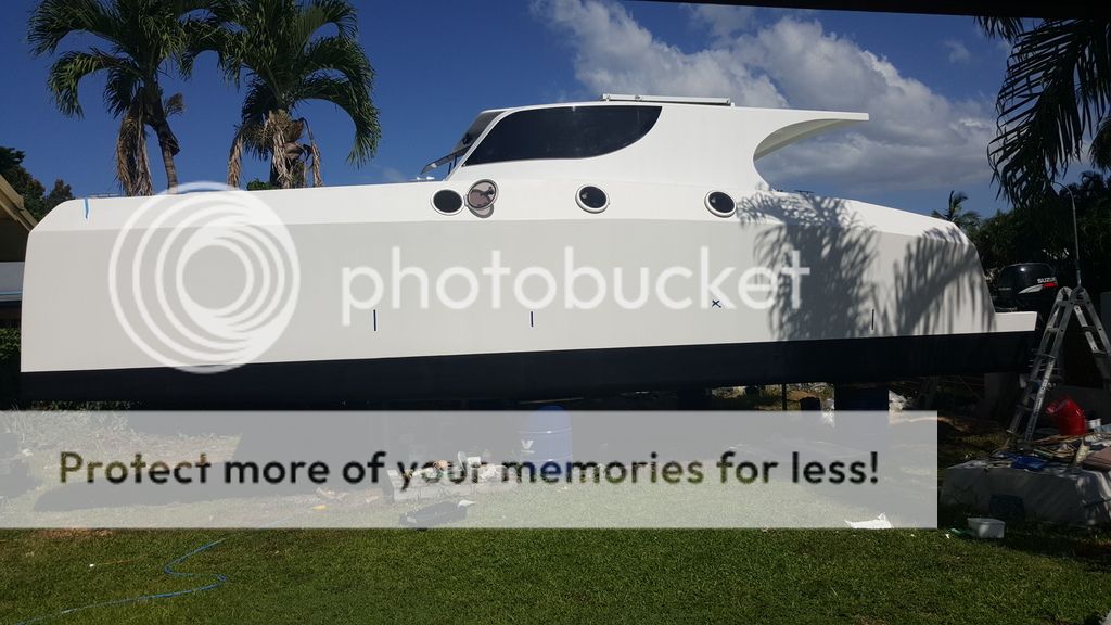

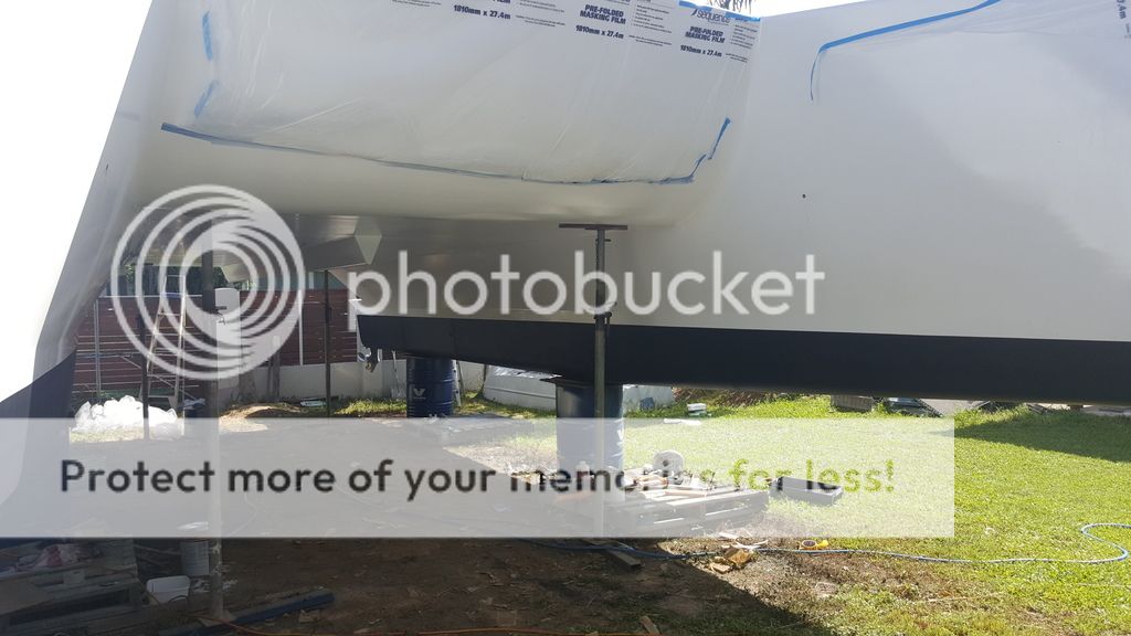

Bottom paint is done, brought the waterline 100mm above where it should float in light ship condition... cockpit floor non skid is next...

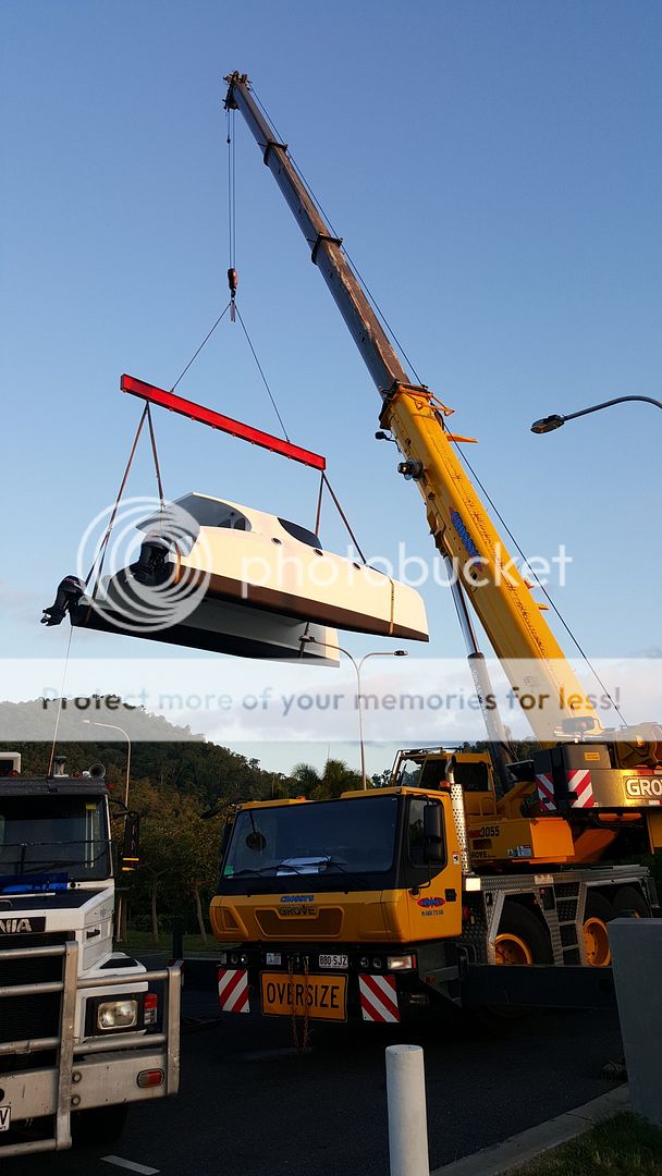

Have the crane and truck booked in for a FEB 29 launch date
so close i can taste it

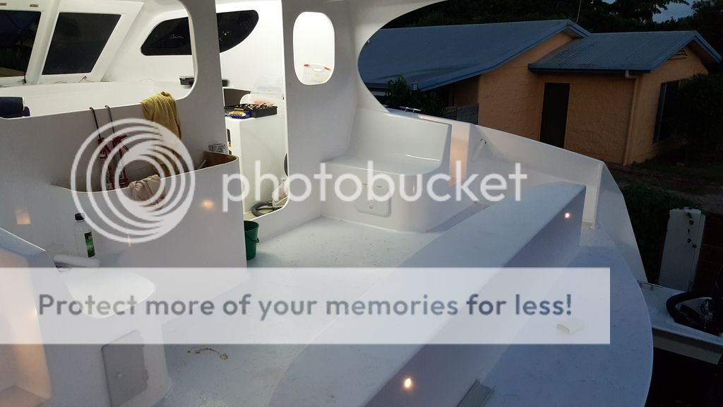

Cockpit floor is done, although covered in mud and footprints from the wet weather weve just had... Just have the icebox to finish - another job for post launch i think... i think im gonna make the inside liner and pour foam over it. After the foam cures, ill cut it back to size so the whole thing drops into the outer case you can see in the pic...

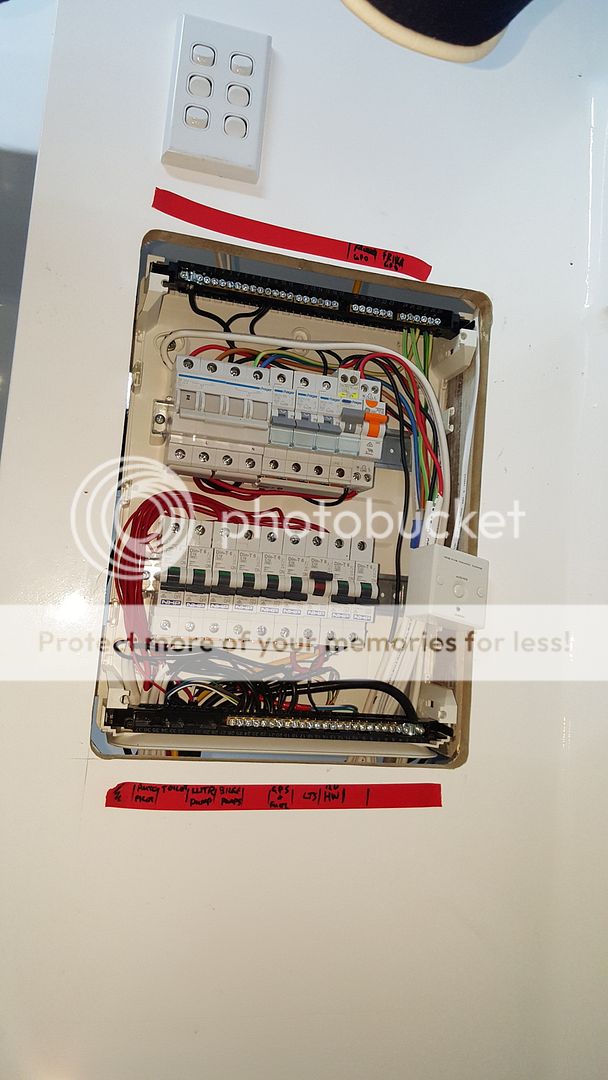

Ive also taken a shot of the switchboard which feeds all of the boats 12VDC loads and also the 240VAC distribution. I used domestic gear - which is also rated for DC, and found this to be a simple and low cost method of wiring everything up. Its compact and works very well. Theres a cover which goes over this and has a nice little hinged door so its all hidden away... 12VDC rail on the bottom, 240VAC rail on top. Main switch on the 240VAC is a "generator changeover switch" - which switches the entire 240V rail from shorepower (fed from the marina) to inverter power from the batteries - the observant will notice ive also made the earth neutral bond here- only on the inverter side, so the RCD`s will work properly. The 3 unused breakers on the top rail are for watermaker, dive compressor and 240v hotwater - none of which are ready to be connected just yet... There are no other bus bars or other junk required anywhere else on the boat - its all done from here...

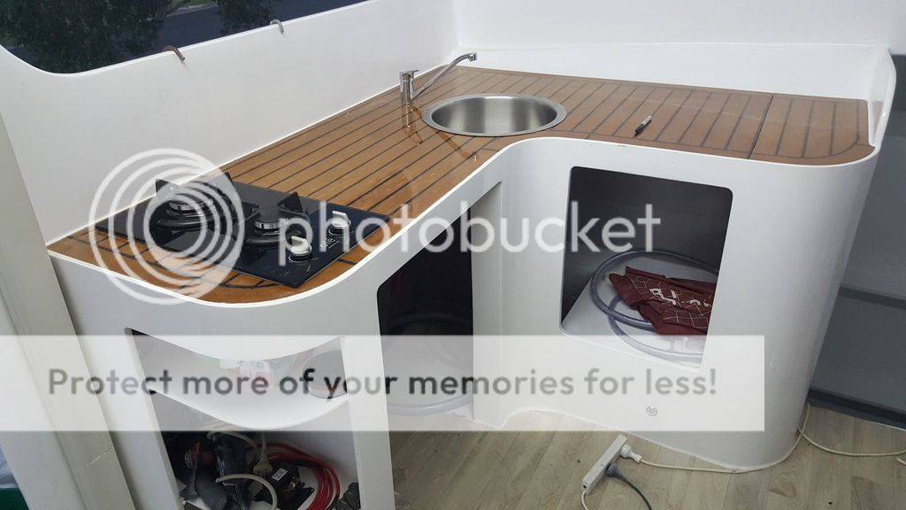

And ive got the sink and stove installed in the kitchen along with my finished 6mm plywood bentop, finished in automotive 2pack clear acrylic urethane from a spray gun... Still havnt faired or painted the cupboard doors yet either - thats gonna be a job for after launch...

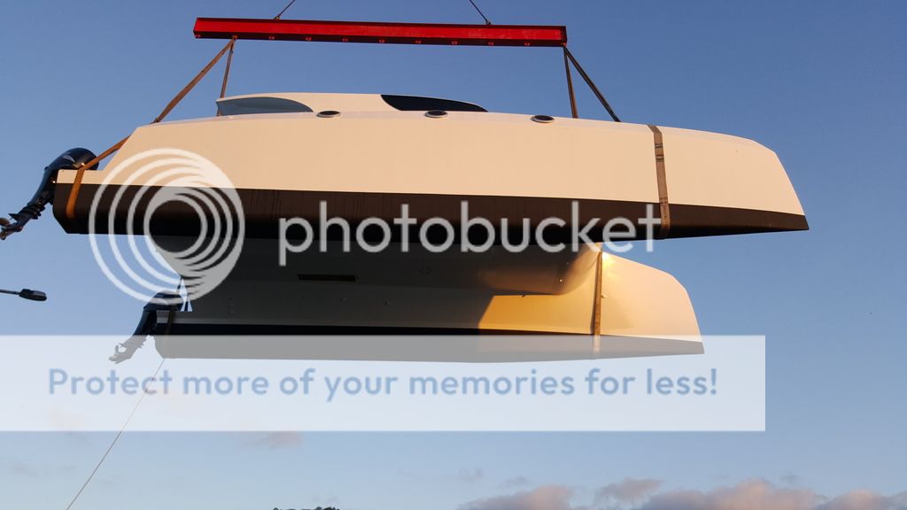

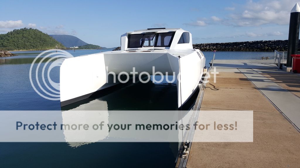

well its all said and done now
Had some serious butterflies whilst it all took place but everything went well... She floats "close" to her lines - a little stern heavy but not too bad... First time we opened her up and managed 27kts @ 5000rpm - props are too coarse to acheive proper rpm @ 5800. I have to keep it short as we heading out to the reef on this glorious day - will update more soon... happy days
