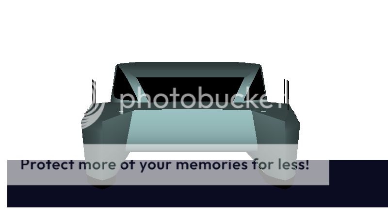

So heres a rendering of the new cabin idea... all bent flat panels, no compound curvature, what do you think? I could get rid of the bent glass front facing windows if i leave the curvature in the A pillars, but recess a flat pane of glass, still raked aft, inside the pillars.
Re: MV Catapult Windows
Ok, ive decided to go for the flat windscreen but maintain the curved A pillars. It looks kinda trick and avoids the extra cost of bent glass.

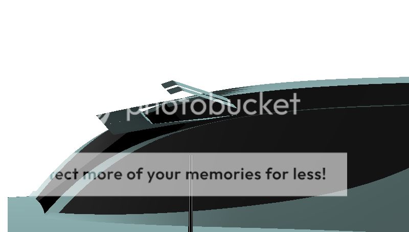

Ive also thought about the sun shade / eyebrow and that it could be vented like a spoiler to let the air pass through it like a wing slot. Above this, ill cut in 2 hatches with an extra lip to catch the airflow thats forced under the eyebrow in an attempt to improve ventilation. Something like this;
Ive also seen an interesting method for creating the window bonding flanges... its so simple i dont why i didnt think of it sooner... The cored panel is infused with the window cut outs chamfered off at 45deg and the 2 skins are brought together to form a single skin solid laminate where the window edges fall. After the infusion, the solid laminate is trimmed back to a 50mm flange and the windows are simply bonded onto this flange to finish more or less flush by the time you allow for the flexible adhesive and the thickness of the window plastic. Heres a pic borrowed from Rob Denny`s harry proa build which shows the result;
And a close up;
